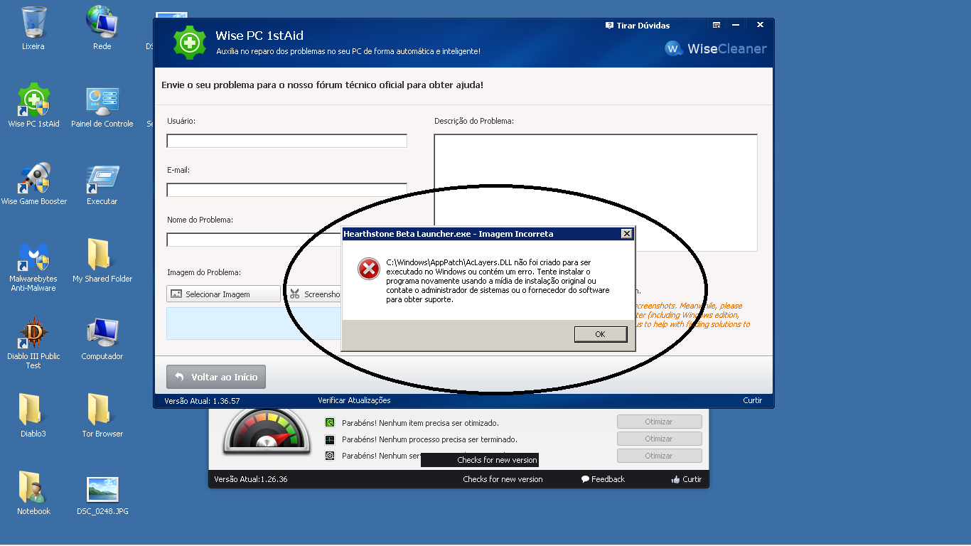

Default Posted August 15, 2014 Report Posted August 15, 2014 Toda vez que eu executo um game aparece aquela mensagem.As vezes nao atrapalha o funcionamento do game mais tem vezes que trava se fosse so uma vez ate que ia so que aparece umas 5 vezes enquando nao aperto em ok o game nao executa teria alguma forma de resover esse problema ? Error when running a game Every time I run a game that message appears. Sometimes not messes up game has more times that locks if so once went so until that appears about 5 times enquando not ok grip on the game would not run some form of this solve a problem? configuration: Windows 7 ultimate 6GB Memory Disk 500 GB I3 M 370 Intel HD Graphics error message: Hearthstone beta launcher.exe - imagem incorreta C:\Windows\AppPatch\AcLayers.DLL não foi criado para ser executado no Windows ou contém um erro. Tente instalar o programa novamente usando a mídia de instalação original ou contate o administrador de sistemas ou o fornecedor de software para obter suporte. English: Hearthstone beta launcher.exe - Bad Image C:\Windows\AppPatch\AcLayers.DLL is either not designed to run on Windows or it contains an error. Try installing the program again using the original installation media or contact your system administrator or the software vendor for support Operating system:Windows 7 Ultimate (64 bit) Service Pack 1 System root: C:\Windows Available physical memory: 5941 MB CPU: Intel® Core i3 CPU M 370 @ 2.40GHz Drive Info: C: 368,01 GB D: 97,66 GB Internet Explorer: 11.0
xilolee Posted August 16, 2014 Report Posted August 16, 2014 1) Delete CBS.log inside C:\Windows\Logs\CBS2) Note: windows installation/repair cd could be necessary. Launch sfc /scannow from an elevated command prompt, wait until it finishes (15-50 minutes), check the final result (note it down). If it says no integrity violations (or something similar), stop here... Otherwise restart your machine and relaunch the tool. Then, report both final results here. 3) If both results says that there are damaged files and it can not restore them, post here the CBS.log file (upload it using the forum feature or a website where you could upload files). Default 1
Default Posted August 16, 2014 Author Report Posted August 16, 2014 thanks for the help I did all the procedures that you said here and this was the result http://uploaddeimagens.com.br/imagens/sem_titulo-png--8643 A Proteção de Recursos do Windows encontrou arquivos corrompidos, mas não pôde corrigir alguns deles. Detalhes incluídos no log CBS.Log %WinDir%\Logs\CBS\CBS.log. Por exemplo c:\Windows\Logs\CBS\CBS.log Windows Resource Protection found corrupt files but was unable to fix some of them. Details are included in the CBS.Log %WinDir%\Logs\CBS\CBS.log. For example c:\Windows\Logs\CBS\CBS.log
xilolee Posted August 17, 2014 Report Posted August 17, 2014 Did you run it twice or once? Could you upload the cbs.log?
Default Posted August 17, 2014 Author Report Posted August 17, 2014 I ran 2 times and this was the result If you can pass me the link to the cbs.log I download and solve my problem
xilolee Posted August 18, 2014 Report Posted August 18, 2014 You can use speedyshare.com to upload your CBS.log (It is in C:\Windows\Logs\CBS folder). Then post the link to your cbs.log here.
