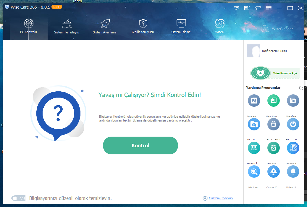

ISSUE 2: LAYOUT IS NOT RECALCULATED WHEN THE WINDOW MOVES BETWEEN MONITORS
Screenshot attached, captured on the 100% monitor after moving the window there from the
150% monitor.
In the Utilities panel on the right, every icon caption is clipped. Captions are truncated
horizontally ("Imag...", "Zorla Sili...") and are also cut off vertically by the following
row of icons. The right-hand panel itself is clipped at the window edge.
This suggests the grid cell height and the panel width are fixed pixel values computed for
96 DPI, while the font is rendered at the current scale factor. The text then overflows the
cell and is clipped by the next row.
Starting the application directly on the 100% monitor renders correctly, so the layout
appears to be computed once at startup and never recalculated when the window changes
monitors.
Since the process declares Per-Monitor (V2), Windows expects the application to redraw
itself on WM_DPICHANGED, including recreating fonts and bitmap resources at the new scale
factor, and to use the suggested rectangle passed in lParam.
